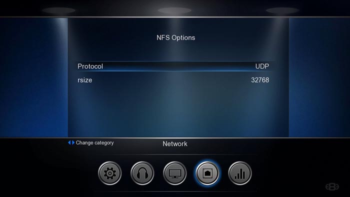

6. Setup Menu ---> Network ---> NFS Options
Set Protocol to UDP
Set rsize to 32768k
